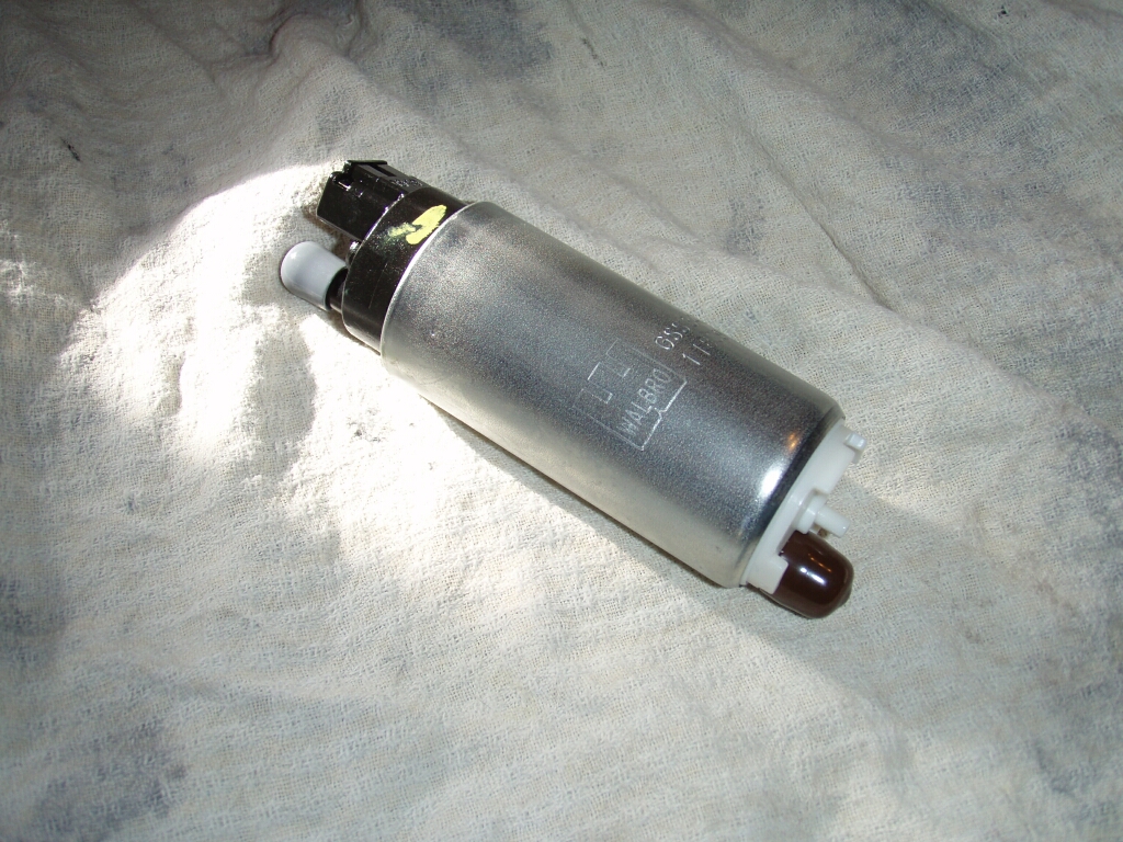

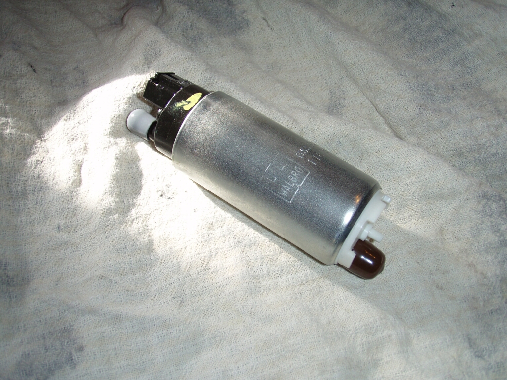

So the pump arrived and I got an afternoon in the garage to get it installed.
Shiney!!!!

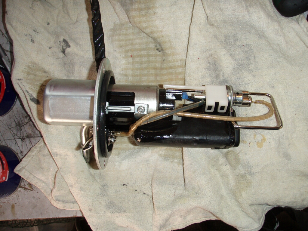

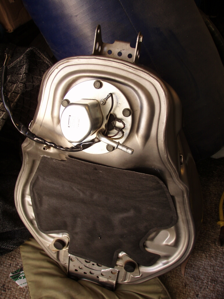

First I had to pull the old pump out of the tank...

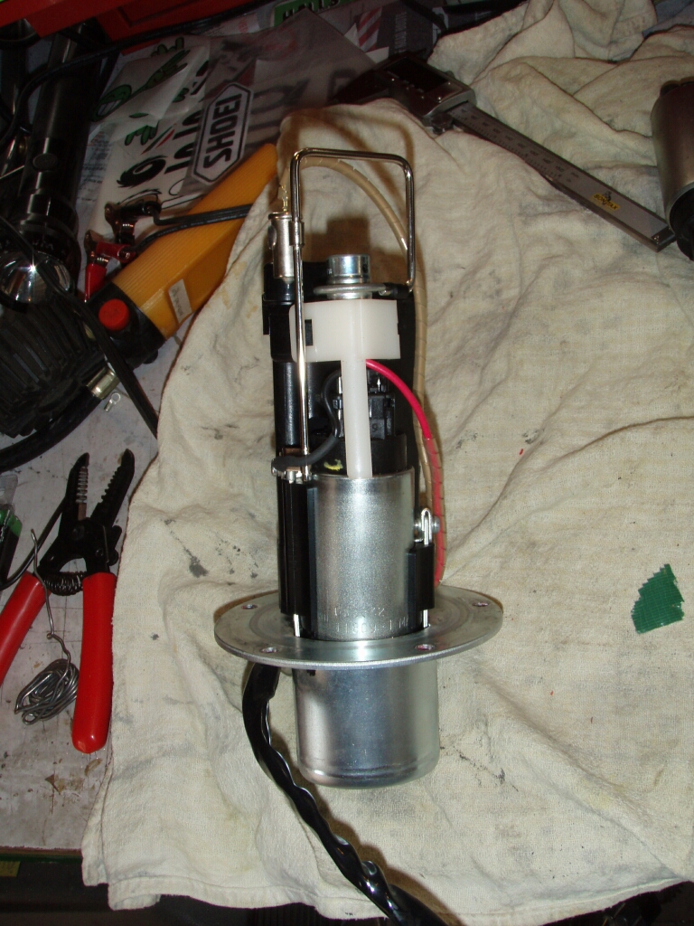

As you can see, the actual pump is buried in the middle of all the other bits...

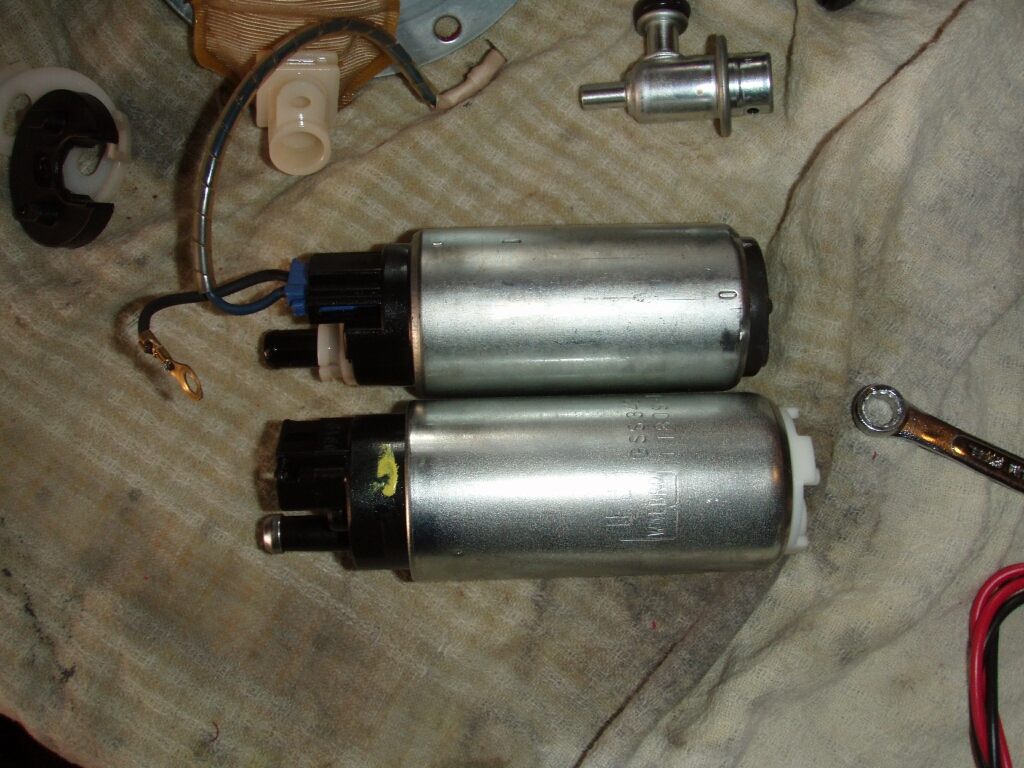

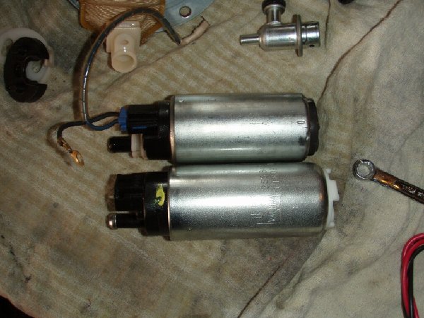

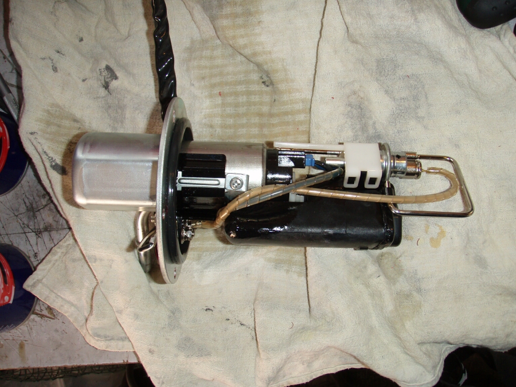

Next step is to pull it all apart to get to the pump and as you can see, the new pump is a bit bigger and not exactly the same at either end, so there'll need to be some modification to shoehorn it in there....

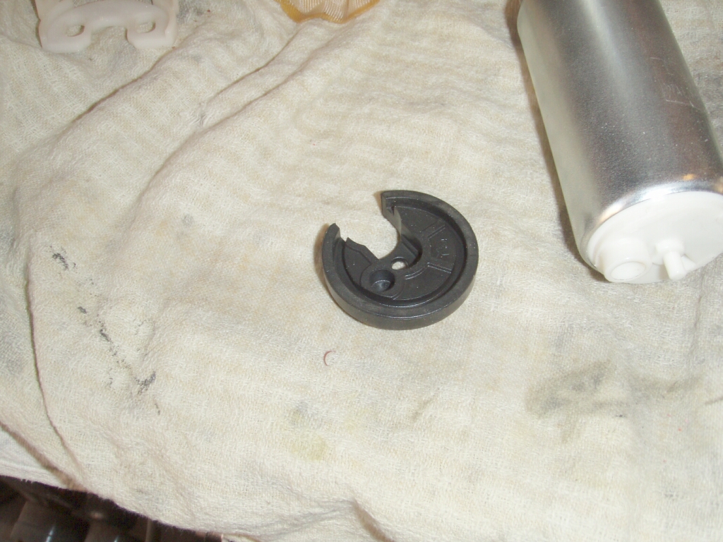

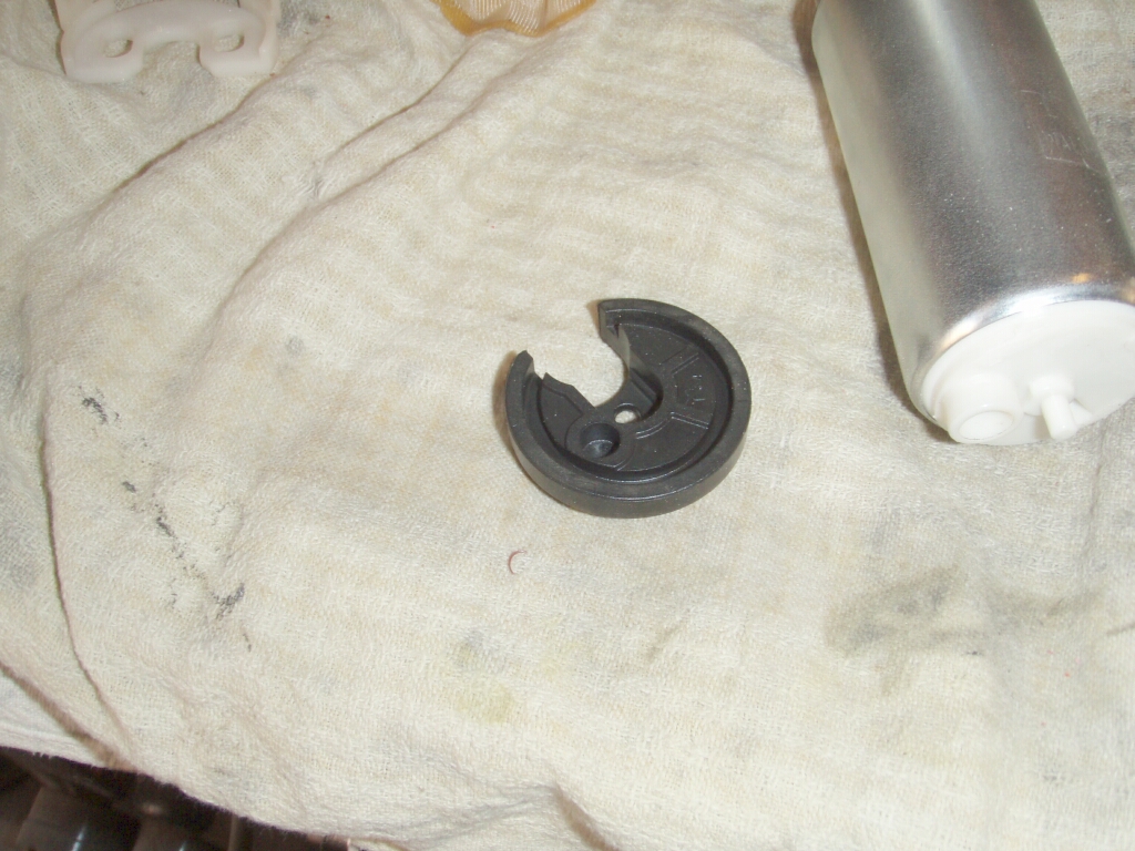

First up the tabs on the end were dremelled off, followed by a fair chunk of the rubber in the middle of the black bit.

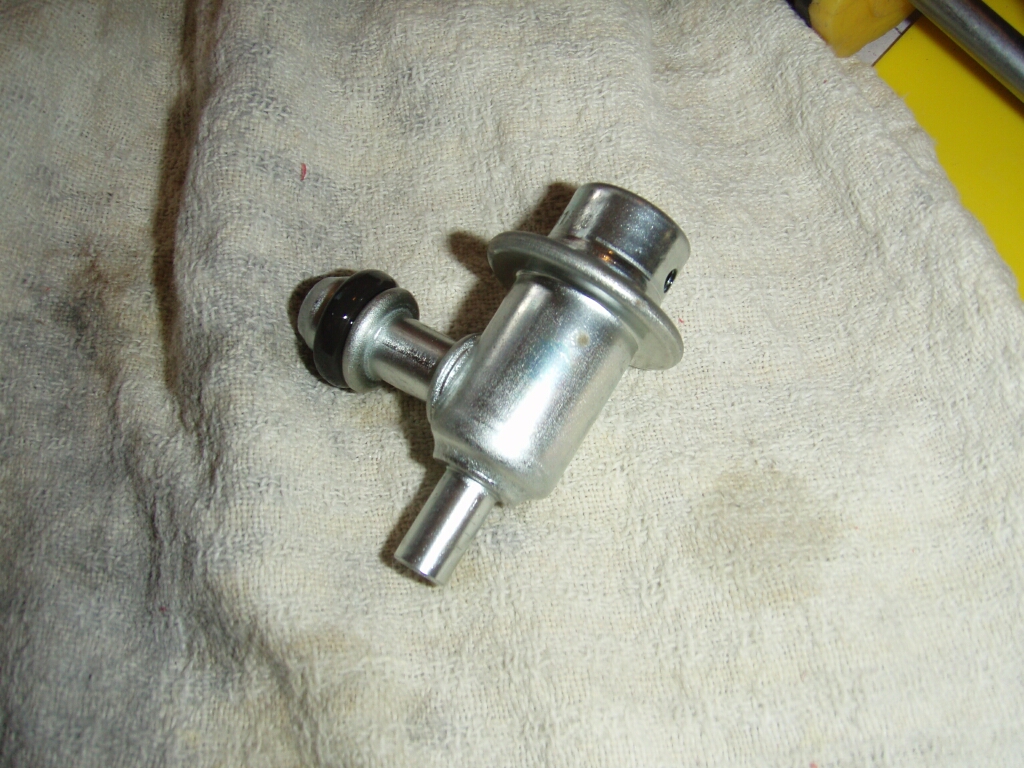

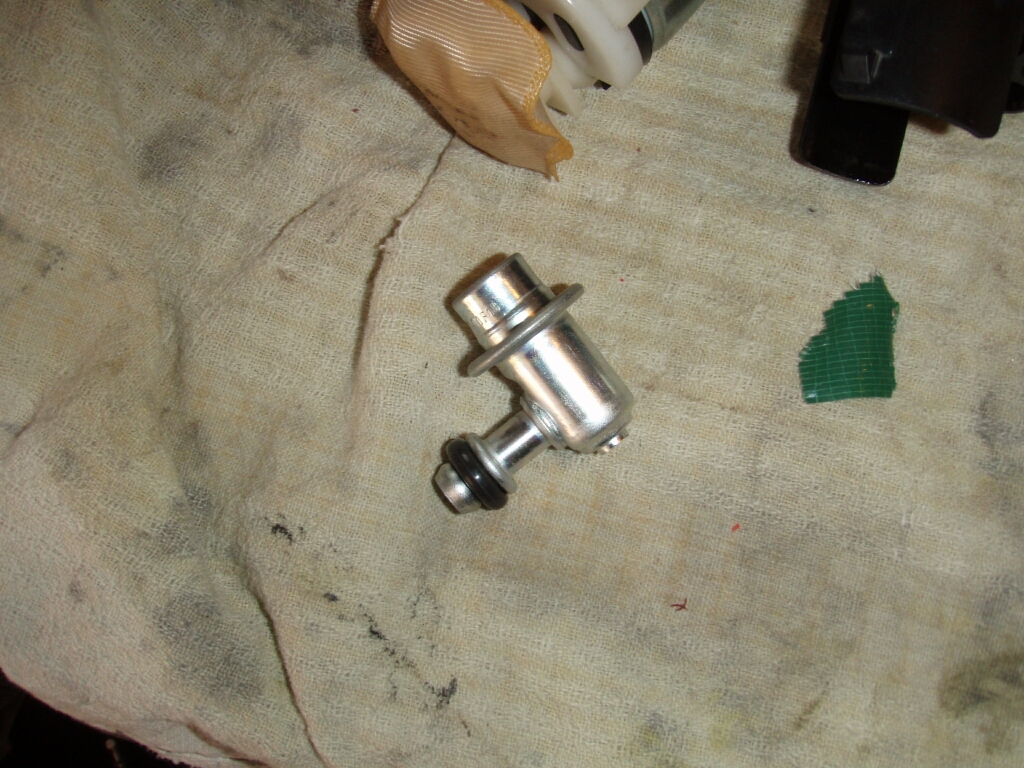

Then the pressure regulator needs to have a bit of the tube on the bottom of it trimmed off to allow room for the plug on top of the pump...
before
after

There are a few other bits that needed a bit of adjustment too which I forgot to get photos of but basically they are the bits at the top of the pump that go over the outlet to seal it where it goes into the regulator assembly. The pump overall is longer than the stock one, but with a bit of adjustment it has fitted in there snugly.
The other thing that needed doing was to solder and heatshrink some terminals on the wires for the pump so it can be connected up.
The end result...
