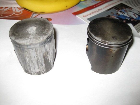

Lean will sorta make the engine rev harder/quicker but not make as much power. I doubt you could really tell on a EFI bike.
The ECU can't self adjust A/F ratios as it doesn't have the 02 sensor to work off, so nothing self adjusts, whatever has been programmed into the ECU is how it will stay, ignition and fuelling wise.
The bikes run on the rich side out the factory anyway, so you *might* be able to get away with it. :lol:
You could seize the engine if your lucky/unlucky . BTW you should have kept your RGV!!!!!
Hot day + wrong heat plug + slightly lean jetting + bad fuel = ...?
