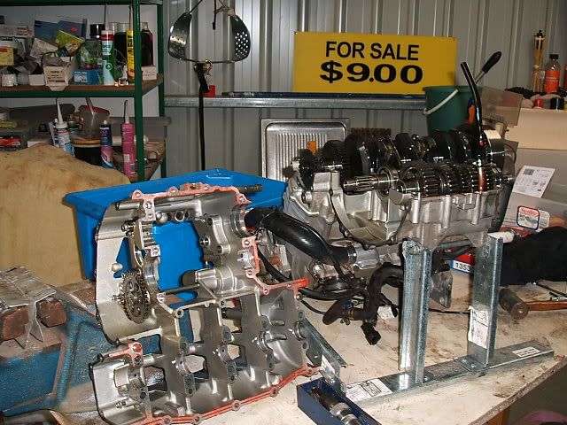

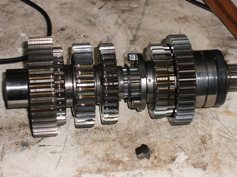

Postby bobtrx » Fri Apr 03, 2009 12:05 pm
Opened up the cases and found the problem , not enough fluoride in the water makes your teeth weak . Parts have gone to my local bike shop to be replaced . The cases have been split before and the gears are undercut , I will find out if that is standard on this model or the gears had to be done . Looks to me like the harding has gone from the gear teeth or is it just fatigue . Does this happen to kawa gears ? I have pic's of the job so far
