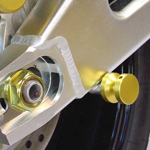

Postby robracer » Sun Jan 18, 2009 6:23 pm
They go here:

This is the bit I'm having trouble with:
No idea where they go etc :( lol .. I'm a total noob with this

Postby robracer » Sun Jan 18, 2009 6:56 pm
The flat black sections go under the swing arm.... no spools required if you use the flat ones ;) But The hooks / spools work better ;)
