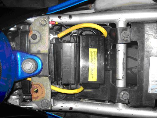

I fitted one to my ZXR250, I was lucky as the bike has a little tray right behind the battery and Junction Box:
Battery Angel 1.JPG (39.91 KiB) Viewed 2896 times
Basically, the unit acts as a break on the Positive feed from the battery, and stops any drain from the battery at all, if tripped.

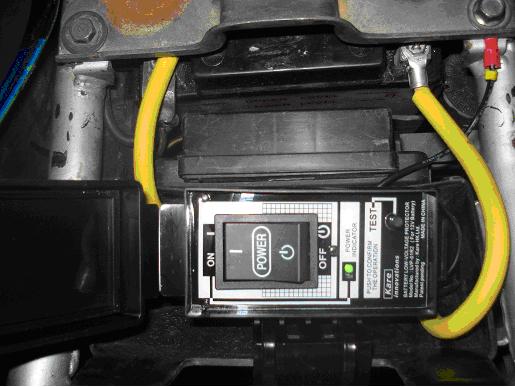

To turn it back on, all I need to do is pop the seat, open the lid to the Battery Angel, and flick the Switch:

To fit it, all I had to do was secure it inside the tray (Done by securing via Tie Wraps, there are slots in the device for this exact purpose (Tie wraps provided), then connect 1 Yellow wire to the Battery Positive, and the other Yellow wire to where the original Battery Positive lead went.
Then only one other wire (The thin Black wire), that allows the switch to operate when required.
The Battery Angel has a test button to make sure all is working after installation - Works a treat !
