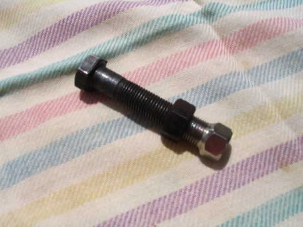

Whoops, don't know how that got here. Thats actually a torque wrench adjuster used when I work on the Harleys :P

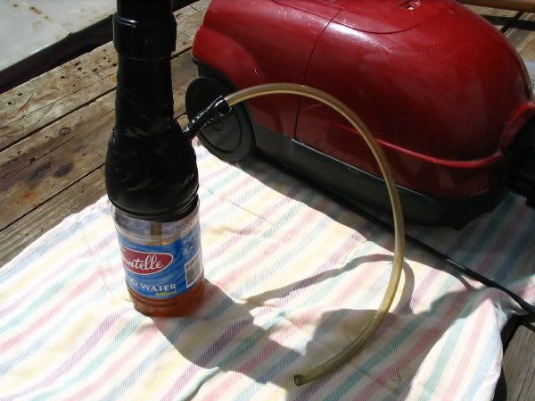

This is my favorite. No it's not a high tech illegal drug impliment . It's a power bleeder. Slip the tube onto the clutch/brake nipple turn on vacuum, loosen nipple, pump lever a few times, and retighten nipple. Great for getting those last pain in the arse air bubbles out.

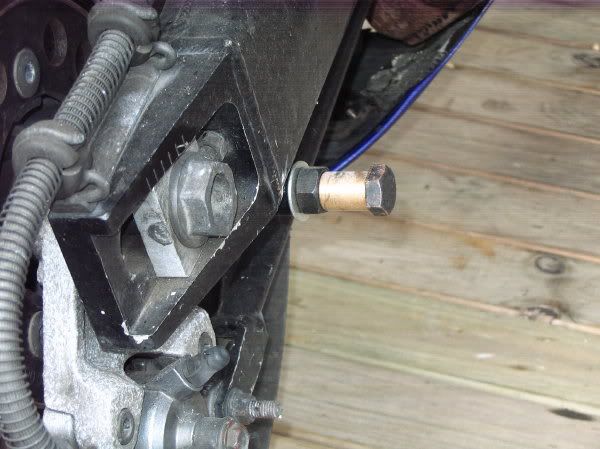

My $3.00 rear paddock stand lugs. Two 65mm high tensile bolts with some brass bushes slipped on. Shit I'm a tight prick :D
