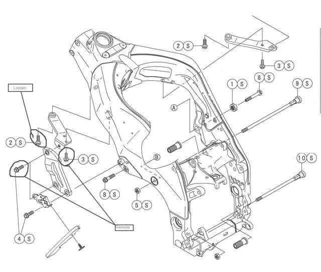

The plugs don't need to be changed until the 24,000 km service as they are iridium plugs standard. When it does come time to change you don't have to take the radiator but they are still a pain to get out. You have to remove two bolts from the engine mount and loosen the third so that you can swing the mount out of the way to reach the outer spark plugs, do one side at a time though. Have a look at this pic, don't laugh at my crappy paint skills :P
I forgot to mention the air box is somewhat difficult to remove if you have not done it before. Try and push the intake tubing back into the frame, you don't want to pull this out as its a real pain to get back in. Then have to twist the air box diagonally up and out with a bit of force.
I hope that helps somewhat. :)

Thanks lads. I think you're right about the 24,000 Paz, although the original workshop manual says 12,000 I thinks it's a typo, just like th no oil change at 18 :?
