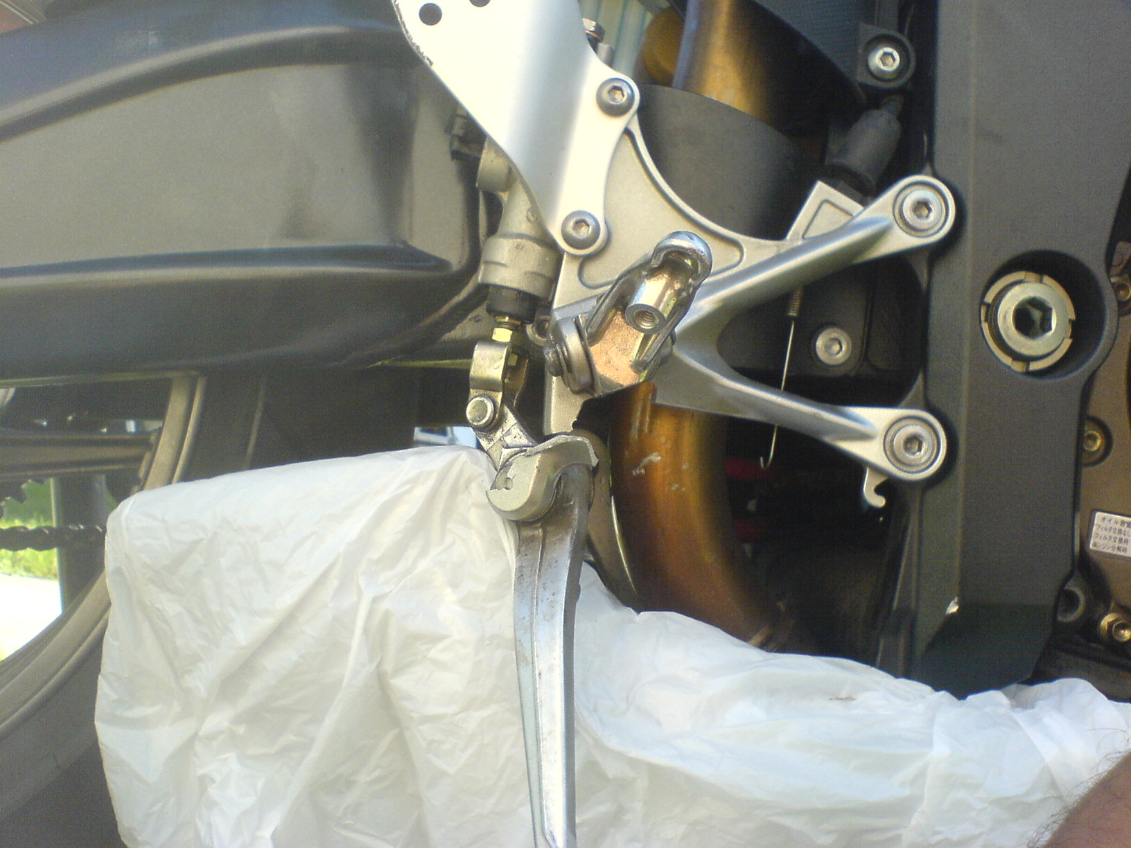

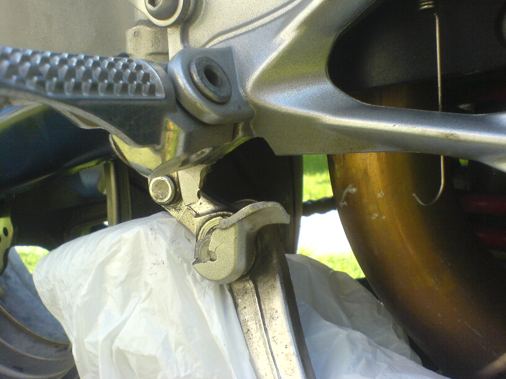

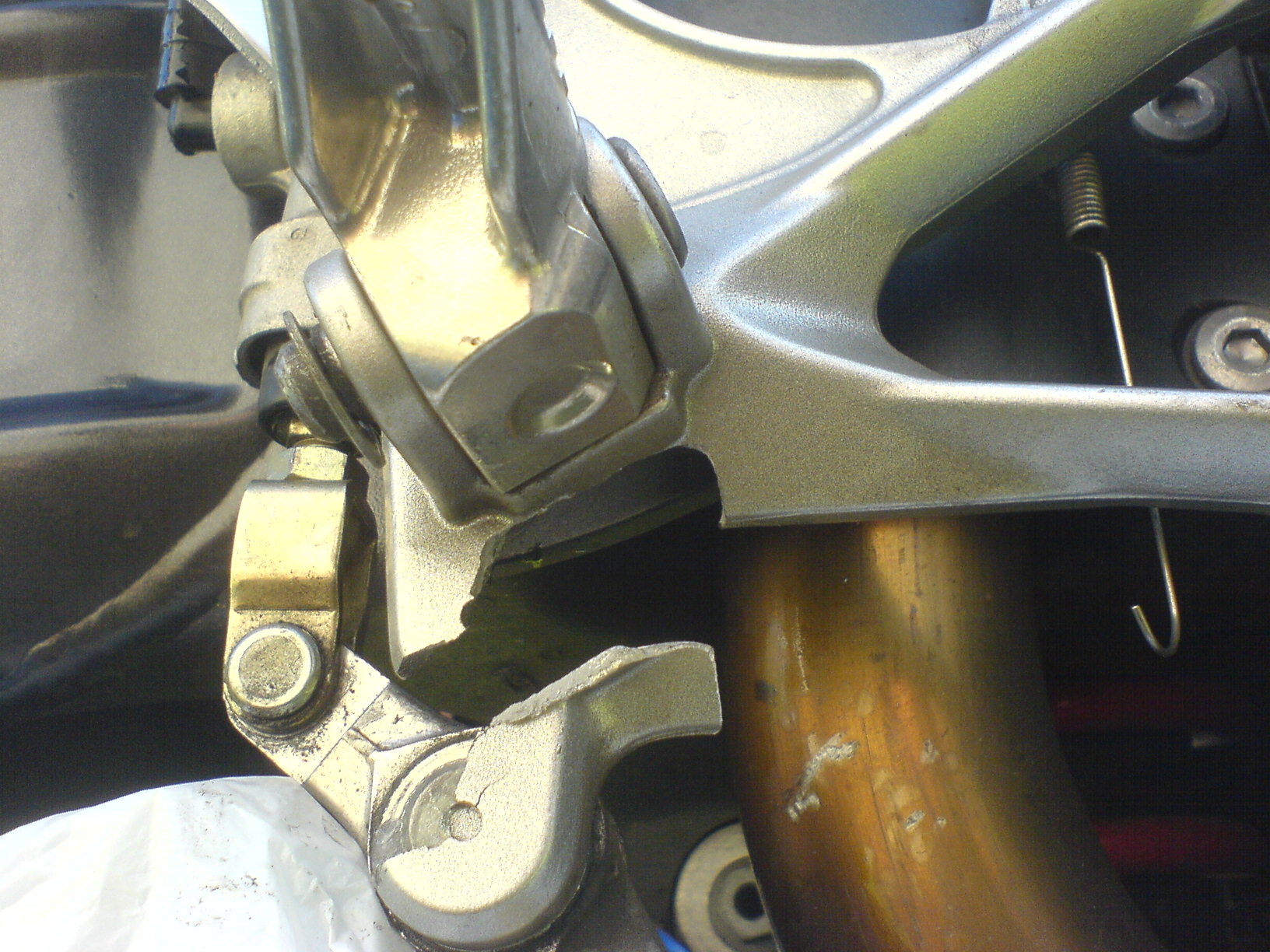

Hey guys,
check out what happened to my rear brake lever, when i was bleeding the brake...
pretty much, i was pumping the brake to bleed it, then when i was holding the brake to tighten the bleed nipple, it just snapped...
now my questions to you guys are:
1) what are the chances of kawasaki doing somethin about this (i.e. replacing it for free), considering it snapped with only a bit pressure from my right arm... PS: I dont know if its still under warranty, as its an 05 model, and the previous owner (bikes 2nd owner) didnt get the warranty details when he bought the bike..
2) if kawasaki dont do anything, what would be the cost of a new rearset??
3) is it worth me getting totally new adjustable rearsets (another brand)??

Postby Plaz » Sun Apr 15, 2007 7:49 pm
My Guess would be it had a minor fall on that side and cracked......doesn't take a lot to break them. I have a spare floating around here somewhere I think........pay me what it cost an postage and its yours, Only catch is its complete with the foot peg , rear caliper, brake lines and rear master cylinder, so it may work out cheaper for you to just get the new bracket, I think they are about $150 to $200 from Big k

Postby Gosling1 » Sun Apr 15, 2007 7:52 pm
:? thats a bit odd - but castings can and do fracture (as your picture proves), its odd that it has lasted a couple of thousand cycles with normal pressure from a foot, but one bit of pressure from the hand, and *whammo* its fucked.... :?
A replacement rearset from Kawasaki Oz would cost at least a couple of hundred bucks.... :? Maybe better to get a set of rearsets I reckon - W4U rearsets are a bit under $500......you might be lucky and source a second-hand one at the wreckers or here.
Personally, I would take this as a sign from A Higher Being, that its time to buy some rearsets !! :twisted: :lol:

Postby Barrabob » Sun Apr 15, 2007 7:59 pm
I have snapped a peg hanger before it cost 140 bucks for a new one.
I have also snapped of at least 4 foot pegs at 90 bucks a piece.

Postby spadge » Sun Apr 15, 2007 8:21 pm
You could always do a dodgy and get it welded... At least that might give you time until you sort out a more permanent solution. Thats what I did when I broke mine although 5000k's later I still haven't got a more permanent solution.

Postby MickLC » Mon Apr 16, 2007 9:41 am
Not everyone has had bad dealings with Kawasaki Warranty, and for something that's only a couple of hundred it'll depend on the dealer you see more than Kawasaki Australia anyway. I'm on my second replacement tail section thanks to the efforts of my local dealer, and they replaced two other small panels at the back too, all under warranty.
The only way you can find out is ask. Be honest with them and see it they'll help you out. If they won't then you can look at the cost of a replacement with stock or aftermarket.

Postby portaz » Mon Apr 16, 2007 10:55 am
thanx for the reply guys..
im looking at these off ebay.... people from the states have purchased these, and seem to recommend them..
http://cgi.ebay.co.uk/ws/eBayISAPI.dll? ... 778&rd=1,1
have just spoken to kawasaki, and my bike is just out of warranty.... :(
looks like i will be purchasing a new set of rearsets, unless i can find an original set for cheap...

Postby Che » Mon Apr 16, 2007 10:56 am
This is why God invented Motorcycle Wreckers and TIG welders. :lol:

Postby portaz » Mon Apr 16, 2007 12:16 pm
spoke to victorian motorcycle wreckers in heidelberg, and they have both the brake lever, and bracket for $130...
however, Im going to enquire at a few places to see if someone can weld it...
