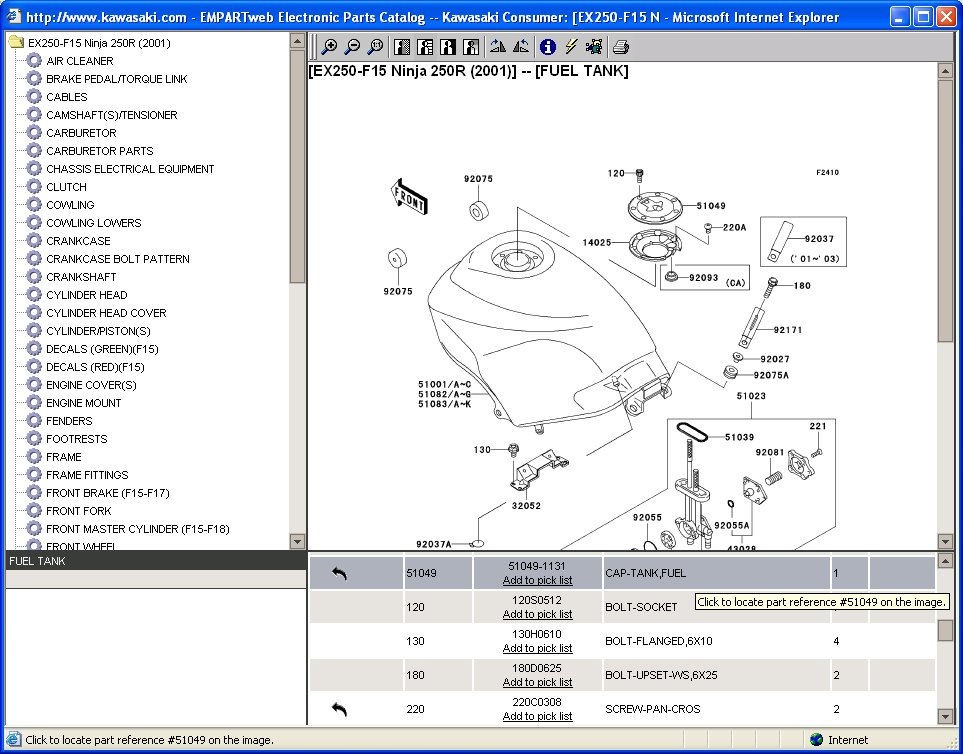

Postby Ratmick » Thu Sep 07, 2006 2:59 pm
If it's a GPx250R (it looks like my old 2000 model) try here:
http://www.kawasaki.com/Default.asp?str ... intParts=1
>> 25mm long according to the diagram.
Note: Be careful, metric bolts come in three common pitches, some are finer threaded than others.
GPX Tank.jpg (150.98 KiB) Viewed 1467 times

Postby WRT_GPX » Thu Sep 07, 2006 8:24 pm
its ok i checked every measurement except for the pitch of the threads which i just based on eye then tested...
