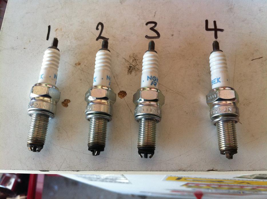

Postby Glen » Fri Jan 20, 2012 10:01 am
Here you go Tim
These were the plugs when it played up last Saturday. You can see 2 and 3 are much sootier
ZRX Plugs 001.jpg (97.24 KiB) Viewed 3604 times

Yep looks to be running richer On 2 n 3, if I remember correctly u said its more apparent when it's hot?
This is only how my brain works, but..... If it started ok after new plugs then played up a bit when warm, then was a bitch and didn't run on all 4 after the plugs have been heavily sooted.
Id be going for the Carby glen, if the original air filter don't change anything then I'd be looking at needles and jets. Also mixture screws :)
