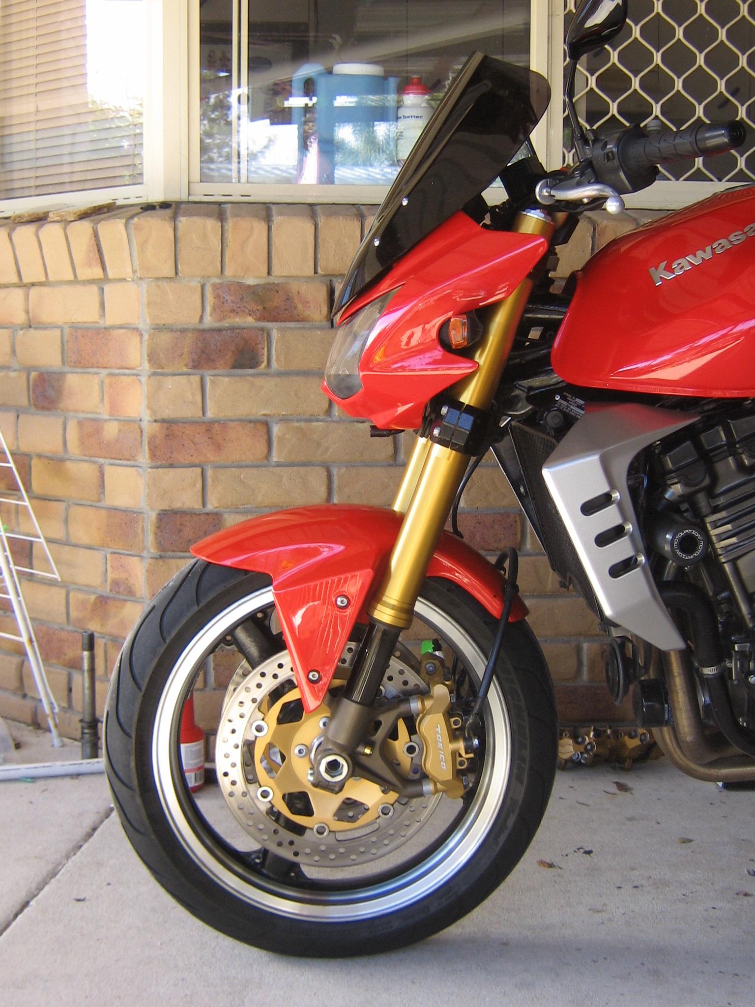

Hi Esie I was in the same situation as you & decided that spending $700 on the front end for good internals... well why not go one better.
I will give a full report once I can get out on a twisty bit of tar so for now its punting round the cit.... from first impressions it is plush compared to stock the bumps are soaked up & a local fast roundabout was nailed this morning with alot more ease than usual.
Compared to a trade up to the 07 this is better & cheaper.
& mate if you are ever down this way it would be a pleasure to let you loose on her :shock:

Postby robracer » Fri Mar 30, 2007 9:21 pm
matt76 wrote:Wow! Great job mate.
Its really good to see people jump in and fix what they dont like on a bike instead of buying something else. That will be one very nice bike, I got the Ohlins shock and got the front forks rebuilt, but if i had the time and nouse that you have obviously got I would have gone the front end like yours. You are gonna love it once you get out to play!
Thanks Matt you are right about loving it! its awesome I am still fiddling & trying to dial it in but this is half the fun, it has really made me concentrate on exactly what the suspension is doing & try to nut out the subtle differences that can be had. My only prob is I am far from an expert & will still go to a pro like Terry & probly find that all I am doing is wrong but at the end of the day I can learn more & gain practical experience about the ins & outs of suspension & set up :D

Postby robracer » Sun Apr 01, 2007 7:07 pm
Neka79 wrote:i didnt read all 4 pages, but wot kinda cost was involved??
i considered a zx6r front fork swap (appparently fits str8 in) but it will require new calipers id say, and one thing i like abt the zed 1 is that its now using nissin 4 pots..much similar in looks to the cbr929 i had, and i kno they work great!!
Bout $1300 for the front end..... went Gixxer cause the internals and brakes were better than the previous model Z1000
I compared spending $700 upgrading the 750 internals but this swap was a better choice bang for buck & the brakes are insanely good compared to stock :D
Full report to come soon about set up.... just got to do it first :oops:

Postby Wattie » Mon Apr 02, 2007 4:44 pm
riderforums.com neka
apparently hayabusa forks go in pretty easy.
rob did pretty minimal work if you ask me. except for the front fender.
bit hard to match my green. :(
