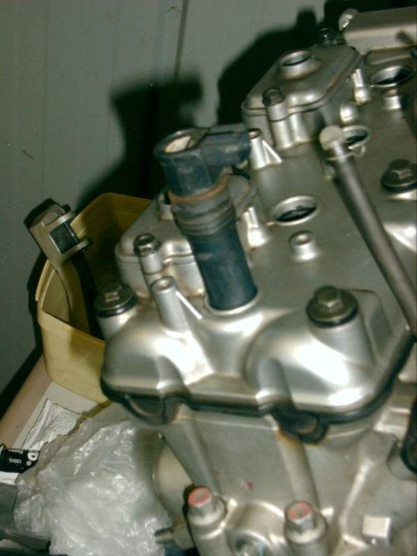

Phil wrote:c'mon I-K, i was waiting for you to say you had an engine for one of those :lol:
Funny you should say that, actually... but I only have one for a G-model, unfortunately.
Tell you what's a spinout, though; the ZX9-C has a cam position sensor. Very unusual for a carbed bike.

I knew I-K would save the day... well, atleast save me from a mistake... gotta get a J series engine.... you reckon (I-K) that the 00-01 was any different, e.g.: they learned how to cast alloys better from year to year?!
I'll print that out and take it to the mechanics..... thanks a mil I-K.

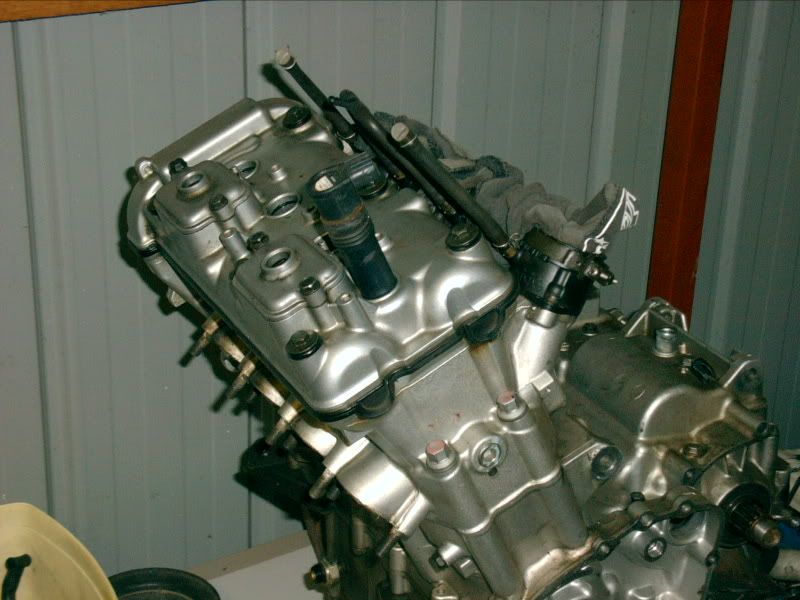

Yankee wrote:heeeeere we go......
okay, rang wrecker in Albion (hint hint) to tell him i won't have the '99 engine as it isn't compatible... quoted the items I-K listed.... he says whoever told me that was "a so and so"... and anyway that it didn't matter, cuz i need the motor not the electrics.....
Ah-huh... I see.
Let him know I like my apology headjobs performed with a mouthful of crushed ice...
And here's a gratuitous shot of a ZX9 in bits.

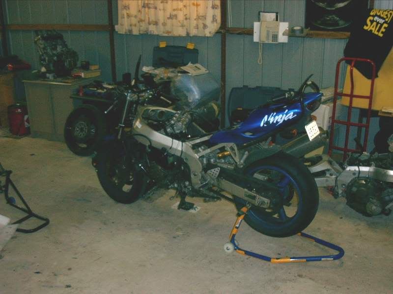

Phil wrote:whats the story with yer 9 ?
Waiting for shims to come in from Precision Shims, and for stock main jets to come in from Japan (can't handle putting more fuel through that bike than I do through the car).
Pulled it apart because it's gotten a bit clattery, vibey and juddery at low revs since coming back from the Island.
Only things wrong with it that I could find were two missing intake port vacuum-bleed blanking screws (top-end pressure-equalisation plumbing removed; I'm putting it back) and a camchain tensioner which didn't, as I've been finding is normal, spring back from the head on its own with the retaining bolts undone-indicating the spring hasn't advanced it enough.
