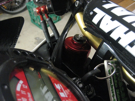

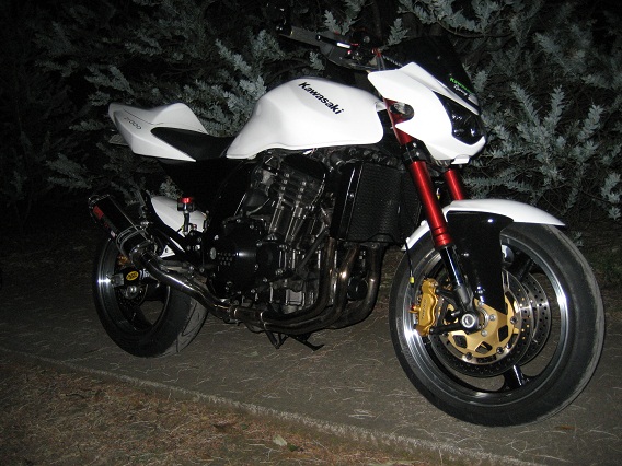

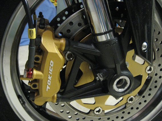

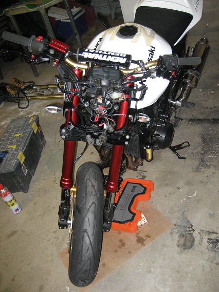

Guess what just went for a run around the block and 'hard'on the brakes to pull up, hmmmm stop! got back to the garage and looks like they bottom out pretty easy.
Soooooo, they can come out again next week and get the MadKaw heavier springs front and rear :kuda:
All up the whole process has knocked me back about $600 plus time and farking around but now the springs have to go in, more time and having to figure out how to strip forks :shock:
Here's some pics I took on the quicky tonight........

Postby Damon Z1000 » Tue Aug 31, 2010 8:47 pm
Pics......
Very Red :shock:
