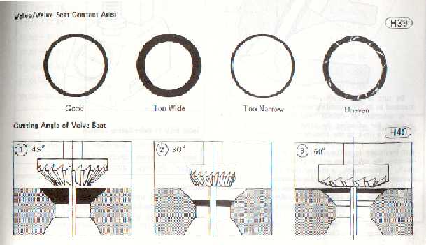

Dj wrote:Gos, wtf is a 3 angle cut?????
....pardon my ignorance......
everytime i read this thread, it makes more and more sense, i can visualise whats being said in a better context.....
this is the only thing that leaves me puzzled however....
I have attached a scan of the relevant page from my well-used Z1000 Factory manual. It shows a '3-angle cut'......the 3 angles being 45deg, 30deg and 60deg, in that order. These are the 3 main angles used in valve seat 'cutters' (the machining tool that actually does the cutting) - this stuff I leave to the machine shop.....
You need the 3 angles in order to ensure that the valve itself is properly sealed against the valve seat ( these are the diagrams above - they show the correct thickness of the valve seal........you use *engineers blue* to determine the thickness (just an ink applied to the back of the valve, rotate the valve a few times, and heh presto, you have an immediate indicator of the thickness...)
3 Angle cut.
