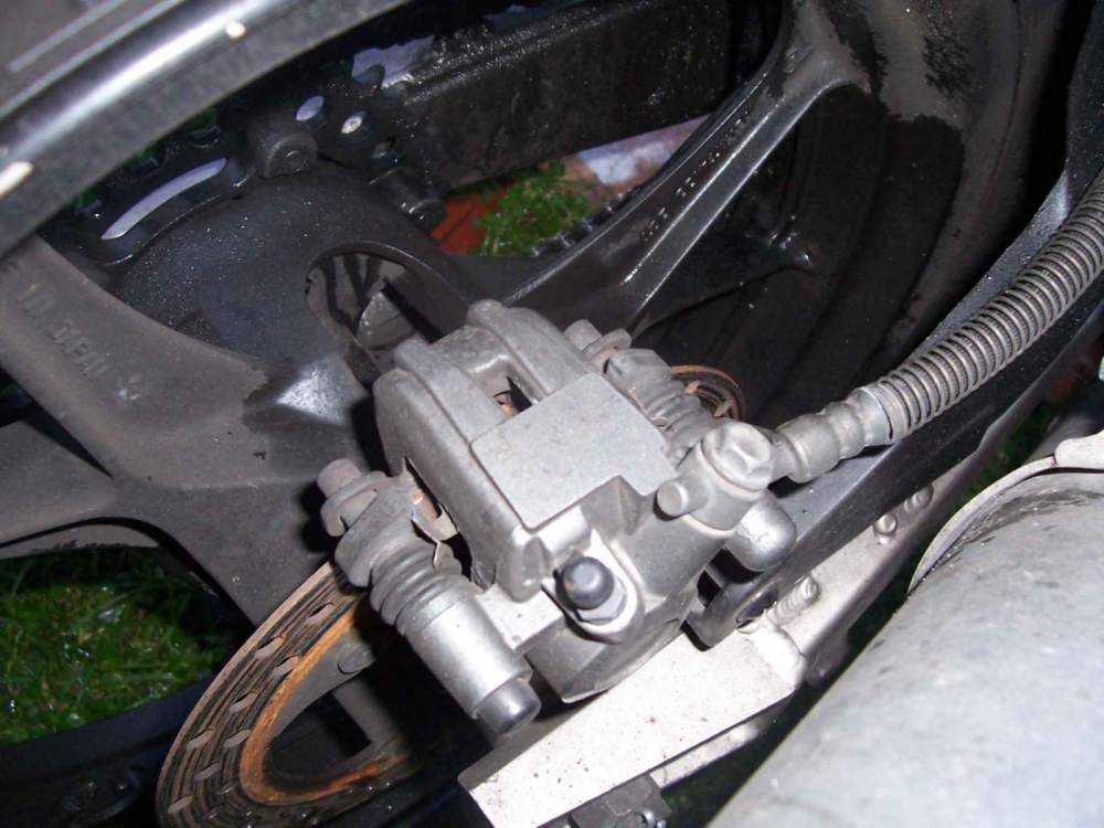

Ok guys i got a picture of the brake set up, just want to be sure which ones i should take out.
cheers.

Postby Tinman » Tue Jul 08, 2008 5:35 pm
Fadz can you see some bolts that screw th caliper to the swingarm there the bolts you need to remove, They are usaully a allen key head.
1. Remove the 2 bolts and you should be able to take the caliper off the disc make sure you dont push on the rear brake lever as you need to get a flat head screw driver and spread the origanal pads apart till they are fully open to the max.
2.Remove the screws that hold the pads in and take out the pads, Put new pads in and and screw back the screws that hold the pad in.
3. Now slide the caliper back into position and re-bolt it after that has been done pump your rear brake lever till it harden back up.
And you should be ready to rock and roll

Is it just me or does that anti rattle shim look a little ordinary?? :shock:

Postby fadz90 » Wed Jul 09, 2008 5:17 pm
define by what you mean "ordinary"?
does something look abit out of the normal, mind you the bike needs just a tad of TLC

Postby IsleofNinja » Wed Jul 09, 2008 9:30 pm
fadz90 wrote:define by what you mean "ordinary"?
That stainless steel shim towards the rear of the caliper should not be touching the caliper slide pin boot. Normally a bit of gentle re shaping with a pair of needle nose pliers is enough though.
As for TLC .... A trip down to your local wash n go for a good degrease and wash will bring her up a treat for starters headbang.gif
