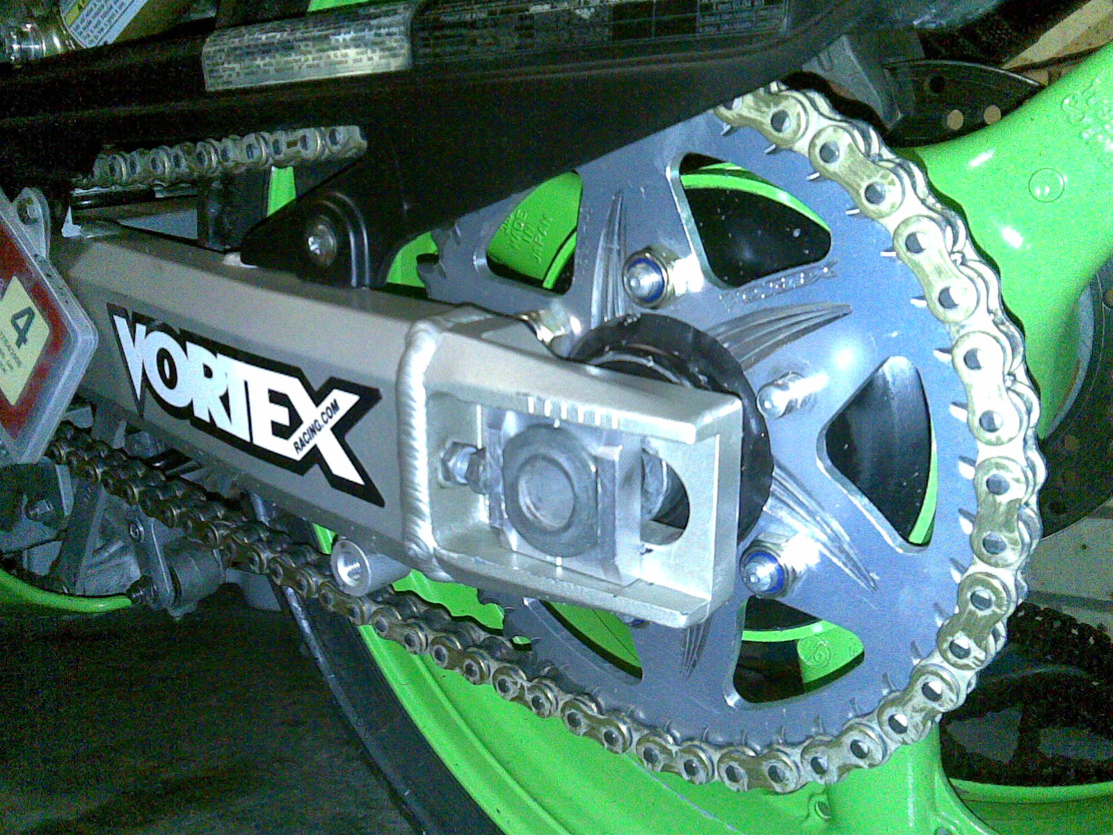

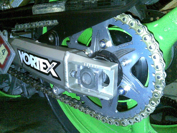

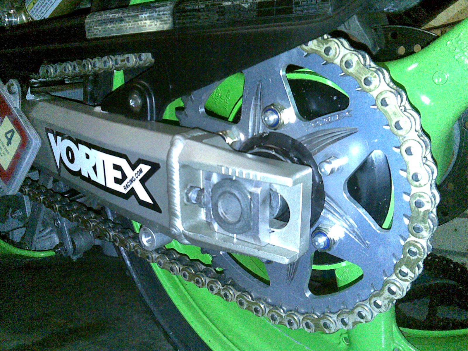

Postby Cooper 6R » Tue Dec 11, 2007 8:04 pm
Hey there
Go the vortex chain and sprocket kit. i bought the same one through the same shop. great people. I had a 15 tooth front 40 tooth back and now 14 front 42 back and loving it. now she gets up first gear under power(power wheelie) and im playing with it all the way through 2nd. im going to try sitting right back and popping it in third i recon it will come up. still getting useto the differance in power although.
I rang the shop for a price on installing it, they said $70 an hour, I said @*#@%$ $70 #@$% dollars. then i asked how much for a chain breaker, they said $20 i said sold.
2 hours latter i was riding around looking like a grease monkey whith a big smile on me dial.
You cant go wrong. it took about a week to get here but worth the wait. Here is a pic
