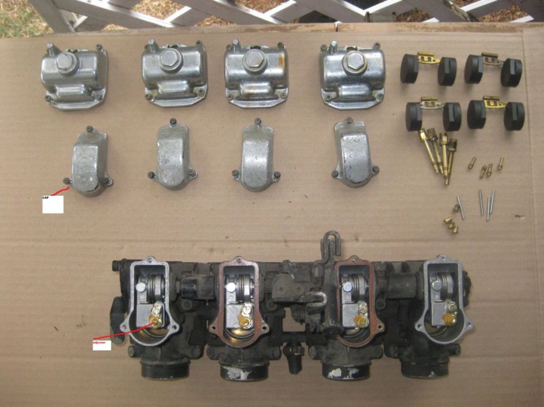

ok gos the info you are giving me relates to cv carbs they are a piece of piss and yes the adjusters are between the carbs i am talking old school mechanical round slides with adjusters under the caps that look like screw and locknut rockers unfortunately i cant take a photo cause some little asshole has jumped the fence during the night and made off with both sets of allen keys which i had sitting on the dog kennel if it had of been a big asshole the could have taken the compressor as well so i cant remove the caps until i buy a new set . i use a 1litre thinners tin hanging from the roof with a breather in the bottom which is the top when hung and i also have an industrial fan which also gets used to keep my stereo gear cool will add a pic if i can find one. ok found pic where is add image i have done images before but cant seem to now

Postby mick12 » Wed Sep 17, 2014 7:08 pm
OK image works i am sure the gaskets and caps are not just to keep the bugs out

Not played with the smooth bores but I'm quite sure the adjustments with my flat slides are done with the caps off. Each carb is adjusted individually.
If you were worried about the slide wear you can always check the balance again once you have all the carb tops reinstalled. Shouldn't take long to check.
Also, keep in mind that the spec for carb balance is pretty wide (2cmHg for my ZRX, I could usually balance the CVs to within a tenth of that). You should be able to balance the carbs just fine.
