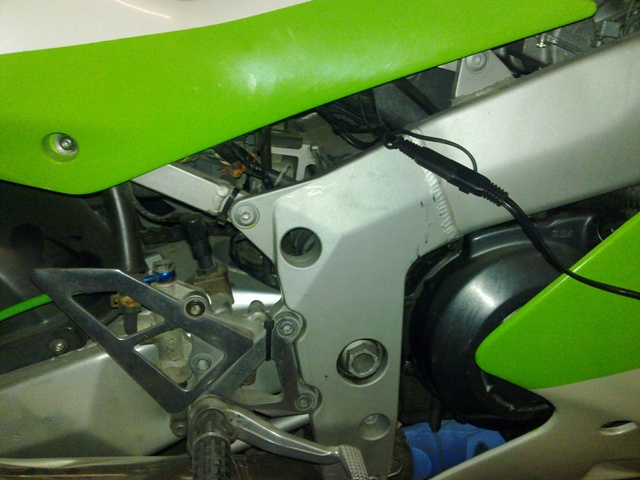

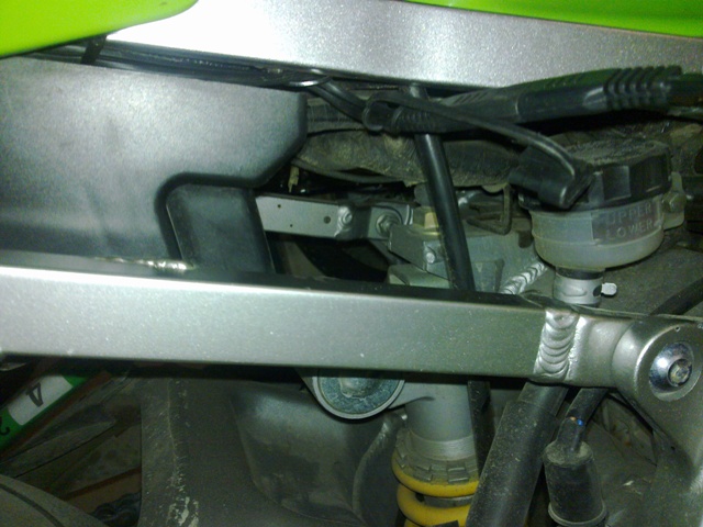

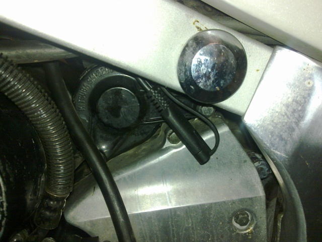

Here's some we prepared earlier (today)...
My FJ1100 just hanging there above the front sprocket cover.
My ZXR750 hooked up to the charger.
Macca's 9 also hooked up to the charger.
The tail leads are about a foot long except the one that comes with the charger which is longer. You bolt them to the battery terminals then poke them out through the side somewhere and cable tie them out of the way. That way you don't even have to pull a seat or a cowl off you just plug them in :kuda:.

Postby Supafrog » Sun Jun 26, 2011 9:30 pm
Thanks for the extra information.
Cable tying it will be i think :o)
I was primarily concerned with how the fly lead was dealt with when not connected to trickle charger as i didn't like the co ncept of it being able to flap about.

Postby Bogan » Mon Jun 27, 2011 9:14 am
As you can see from the FJ it has a weather/waterproof cap and you don't need to leave heaps of it flapping around, just enough to connect it up to the charger.
