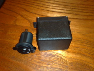

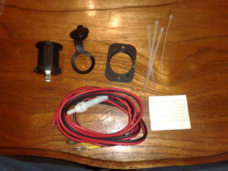

Ok - first step - I wanted a socket that was waterproof and needed to fit somewhere neatly on the bike. I found a waterproof kit on eBay with everything needed - wires, inline fuse, socket with cover and mounting kit - total cost approx $16 delivered.
After looking around the bike I decided the best option was to install the socket in a hobby box I had and attach that to the triple tree. The box needed a couple of holes - one for the socket and one for cables.
Socket and box.jpg (21.39 KiB) Viewed 3940 times

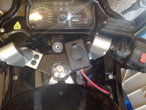

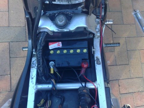

Once that was done it was a case of installing it on the bike...
Run the cables and attach to the battery

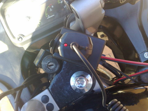

And test
mobile charger.jpg (43.87 KiB) Viewed 3940 times

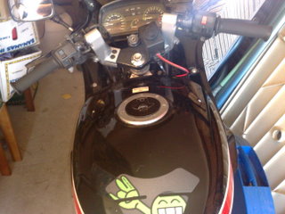

All done
installed 2.jpg (24.56 KiB) Viewed 3940 times
Yes I know the cables could be tidier but as I said I'm working on a better install for wiring in accessories which includes a relay.

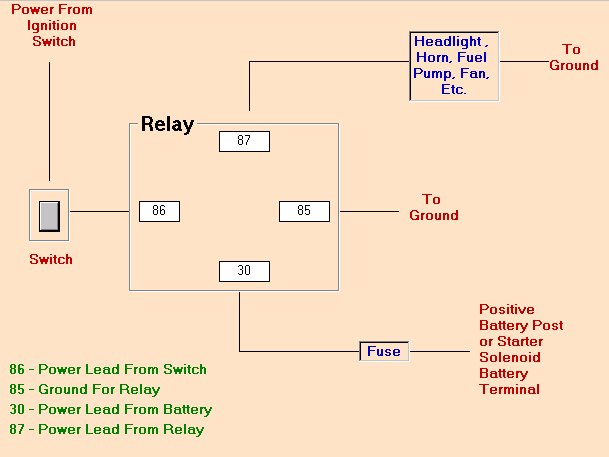

Postby waynemorgan » Sun Aug 16, 2009 8:08 pm
I've just managed to get the gear together to wire my accessories separately rather than tapping into the OEM loom. Basically like this
1. Find a wire which is live when the key is turned on - tap into this at wire it to connector 86 of a 30a/12v relay.
2. Run a wire from 87 to a aux fuse box - couple of options, use a Narva fuse box or go to a wrecker and get a motorbike fuse box.
3. Run a wire from 85 to ground -this could be on the neg terminal of the battery or a frame bolt.
4. Run a wire with an in-line fuse from the + terminal off the battery to 30 on the relay.
You now have a separate fuse box just for accessories - heated grips, GPS, 12v socket etc - just take the + line off the new fuse box to whatever you're wiring in. It will only be live when the ignition is on. Make sure the fuse you install is suitable for your new addition. Each accessory can now be fused separately.
A few proviso's - I'm not an auto-electrician just a hobbiest. Make sure all connections are clean, dry and preferably soldered rather than just crimped - and cover all joints with heatshrink tubing for the best results. Make sure you electrical charging system can handle any other accessories you wire in. Should you blow up, burn down or damage your bike in any way it rests on your head (sorry - just used to covering my arse from possible come backs). :D
I'll be posting this with photos in the next week or so.

I've always found the neatest instal is a relay close to the battery, with the switch wire to the relay taking power from the tail light (not the brake light); that way all the wiring is under the seat and neat. The power for accessories (eg heated hand grips) is still straight from the battery through the relay. I've done a few sets of heated grips that way, with no problems. Fuse between battery and relay. The newer Oxford heated grips with low voltage cut-off still drain enough to stop the bike starting before the handgrips cut-off (I found :oops: ) so they still need the relay. Should work for any accessory.
