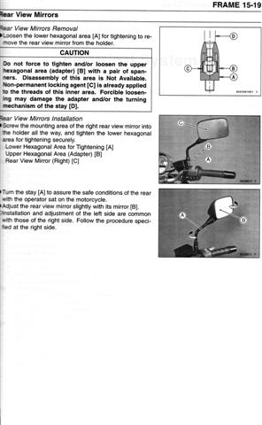

Postby dilligaf » Mon Aug 04, 2008 7:03 pm
on my er6-n the mirrors start turning in once I get a bit of speed up and I have to keep pushing it back.
its not coming loose at the screw (the other side did that and loctite worked) but in the adjustable bit
on the stem. any idea how I tighten it?

Postby 6maniac » Mon Aug 04, 2008 7:42 pm
G'day - hope this helps ;)
IMG (Small).jpg (23.39 KiB) Viewed 1237 times

Postby robracer » Mon Aug 04, 2008 7:59 pm
dilligaf wrote:on my er6-n the mirrors start turning in once I get a bit of speed up and I have to keep pushing it back.
I have the same problem on the zeddy with the original mirrors... I just wind them clockwise till they are tight... but anything over $140 and they flap around again, at the moment I dont care because they are going to be replaced with bar end ones :roll:
Re: farken mirrors
Postby 6maniac » Mon Aug 04, 2008 8:04 pm
For some reason, mine have never moved in 2.5 years and 38000km :shock:
