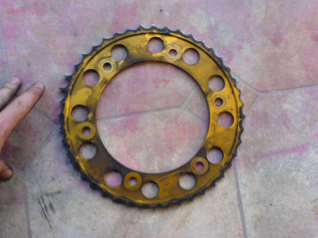

Postby Neka79 » Tue Jul 03, 2007 12:49 pm
aus636 wrote:You can get a 46 sprocket and the ZX6R 05 up is a 520 chain. So this might be a good option as i dont have to change the front sprocket because i have heard that going down one in the front puts more stain on the chain and box.
really?? shit aye....
the zed is 525 which shocked me..i put a 520 on the blade and it chewed it out real quick (see pic of sprocket- teeth were destroyed)... but it makes sense to put thicker chain on bugger bike...
as Strika said, plus a smaller front sprocket means more wear on the front..that why i went up 2 on the back last time...made a difference, not a huge one, but it was a bit more accel...
old one..and rooted one...
pointing to the 2 teeth i had left!!
