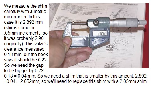

Further study... YES the gap actually closes, not widen :shock:.... boy have I got it sooooo wrong :shock:
Thanks Strika!!!

Well that sounds mighty complex to me :lol: considering to adjust my car's valves:
Remove cam cover 4 screws (12mm)
Grand total of 4 screws
:lol: but I got to do it anyway so it will... I think the 8hrs taking account of going to to shop to get the new shim. This can't be pre-prepared as the current gap needs to be measured :cry:
