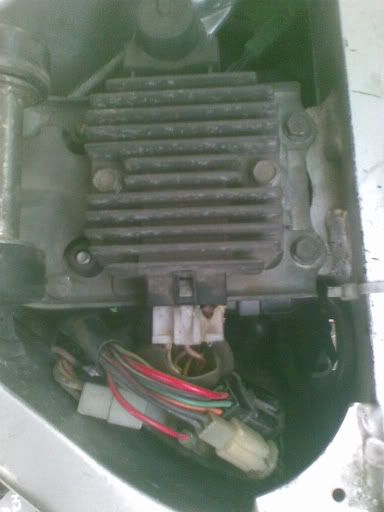

ok i got it sorted now i rekon.
This was the problem...
the plug on this thing, whatever it is, had burnt out. i have not fixed it properly yet, all i did was clean it up and put some special grease on it.
done about 120 kays today on it, i sorta ran out of fuel twice, and it worked fine.
now i just need a new 1 of these plugs

id also make sure that the rectifier itself isnt shot.
things like plugs dont usually melt "because they feel like it", there has to be a reason for it to shit itself.
Re: Charging problems
Mon Sep 01, 2008 12:50 pm
As MikeS said, that is the rectifier. What this beauty does is regulate the charge from the alternator. The more you rev, the faster the alternator spins and the more electricity it creates. This would easilly fry your battery and other delicate electrical bits 'n' bobs, unless it is regulated. If a wire is burned, it's probably not regulating voltage. A new one will be under $100 and save you heaps in the long run.
