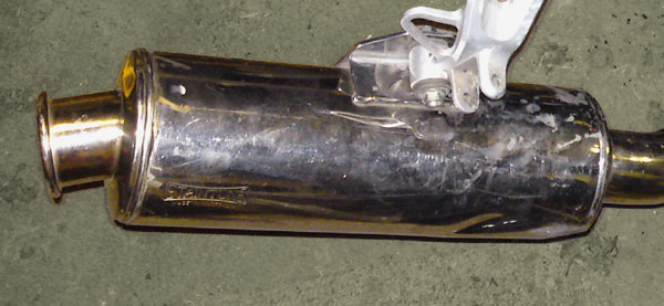

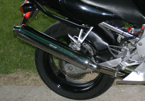

Change 1 is well under way. I think you'll agree that while almost street legal and not particularly fat, the the silencer is not very 'race'. Or should that be was not very race...
Before
And after today
Notice the positioning of the Staintune logo. A total of 210mm has been removed. There is no swing arm in the pic as it has been removed ready for the spool lugs to be welded on. Haven't sound tested the exhaust yet as bike is stripped ready for clutch change and has no fuel supply. The can doesn't look quite as nice as the first pic, but four years, 65,000Km, and dropped twice has taken it's toll.

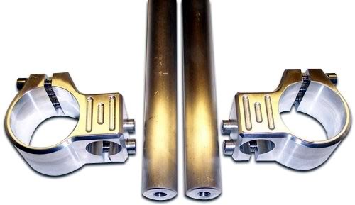

I purchased a shiny new set of clip ons, and have mounted them under the triple clamp. The bars are now significantly lower, perhaps 80-100mm. There are many more mods happening, so I cannot test ride the bike but just sitting in the shed it feels great - like a race bike.
Clip ons

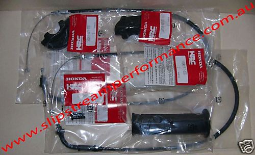

Now, while I had the front end stripped, I decided to add a bit more bling. OK, more like when I was on the net buying the clip ons I purchased a bit more bling. First on the shopping list was a HRC 1/6 turn quick action throttle. Stock the throttle is about 1/3 turn, I had a Rifleman insert bringing that to 1/4 turn, but I wanted more The HRC unit comes with a whole new throttle housing, as the 1/6 turn throttle tube does not fit in standard housing. It also came with new cables as the outers are a different length.
Throttle parts

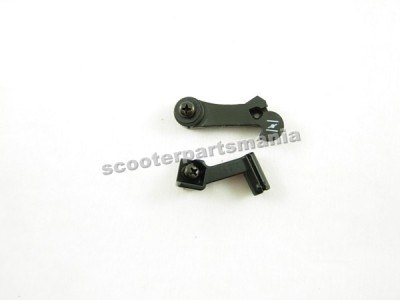

As the switch gear was being removed from the right hand bar, I thought it best to remove the left switch block too. Only problem here is that the stock road unit had a built in choke lever, so I went back online and found a bracket and lever to mount the choke elsewhere.
Choke parts
So far the clip ons are on, the throttle is on and the cables are half fitted. I just have to get them in place on the carbie. The starter switch is here on my desk waiting for my next shed session. The choke lever is expected to arrive Monday. I also have a nice shiny new shark fin for the swingarm, which will be fitted soon.

I've got the same clip ons fitted to my ZX9R can you post a pic of them underneath your top triple clamp? I'm thinking of doing the same. By the way nice mods you've done, I'm a huge fan of the shorty pipe also.

HRC 1/6th turn throttle and cables are fitted - what a bitch. Did the job without releasing the carbies, and the return cable was almost impossible to fit. Once that was done everything was a little too tight (Slow return particularly on right lock. Cut 5mm out of one outer cable and she’s as good as gold. This mod will hence forth be known as the HRC throttle on/off switch.
